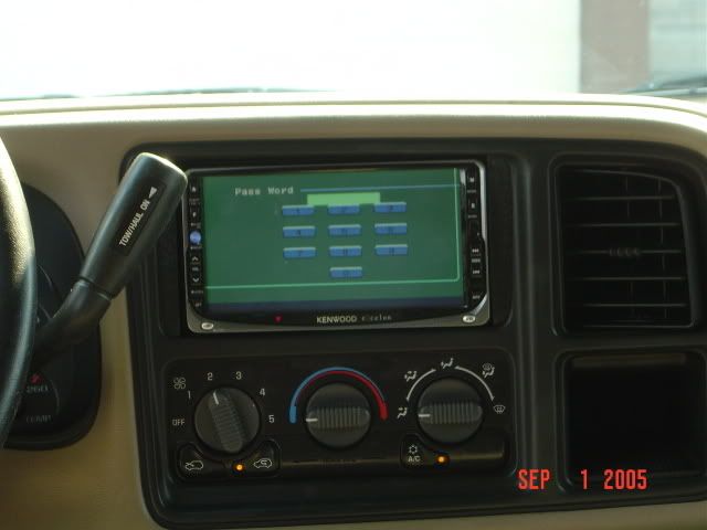

Welcome! Only 03-up models had double din provisions. But with some trimming and bracket fab'ing, you can get a double din into the earlier models. I attached a pic of a double din Kenwood unit I installed for a friend of mine in his 01 Chevy.
JK - did you have to fab some plastic to go around the sides? Isn't the stock trim just a little wider than DIN?
Hard to tell in the pic. I'm looking to put in a DD 7" DVD/Bluetooth head unit.

Sorry about the pic; it is hard to tell. But I did have to make a trim piece to go around the sides of the unit. The opening side to side is wider than a standard DD.

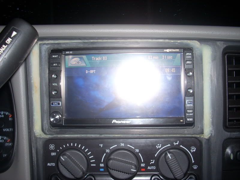

Its good to see some people have been able to put double dins into the pre 03 Tahoe's. I have just bought a pioneer avic Z2 thinking my Tahoe had a double din.
Most local radio shops say they wont attempt to modify my dash, but I have found one that will do it, but they want to move my HVAC controls down to the middle console. I would really like to squeeze this thing in without doing that. Do you think it can be done? If not then looks like the HVAC controls will be going down b/c I really like the Z2

Some of you may have already seen this, but HERE is a link to the thread I started on installing a double din Pioneer D3 in my 01 Tahoe. The HVAC does not need to moved down. The instrument cluster bezel will need to be trimmed though and brackets fab'ed.
