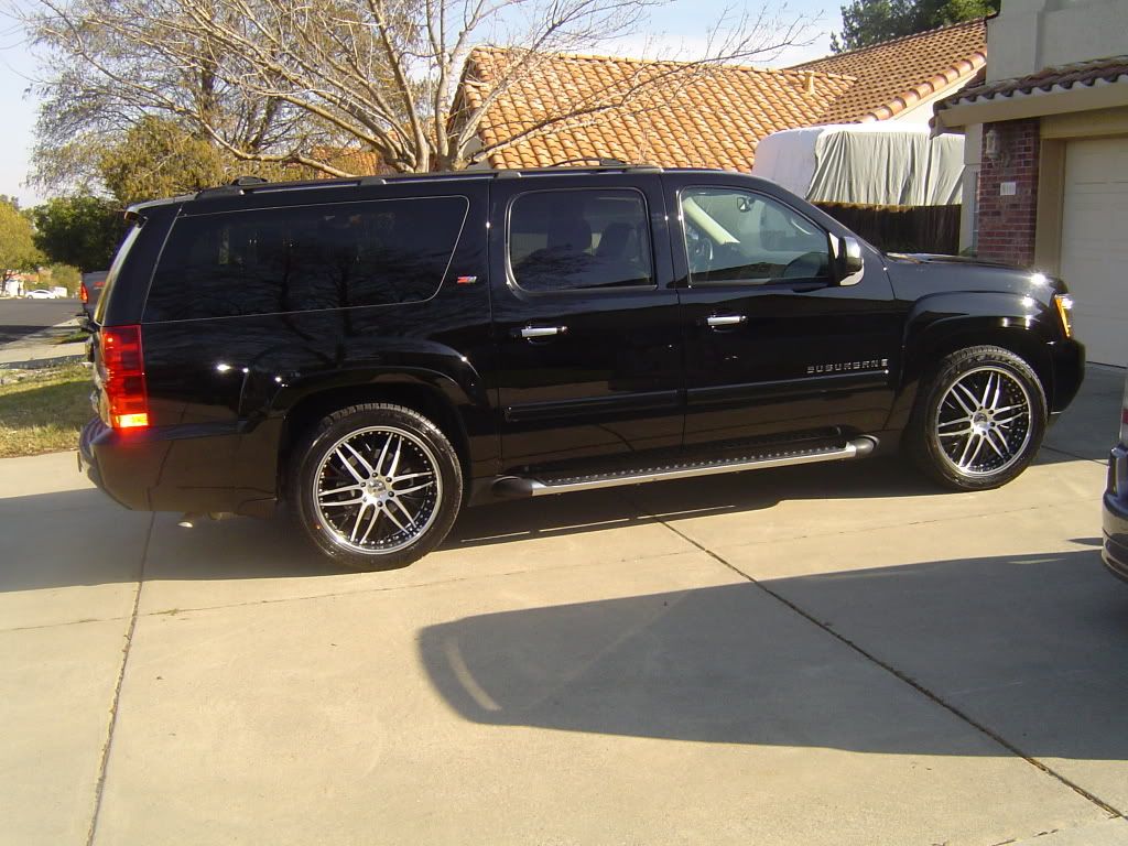

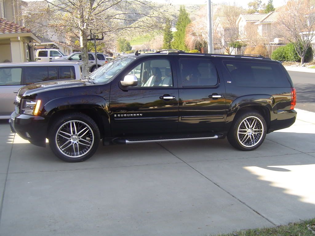

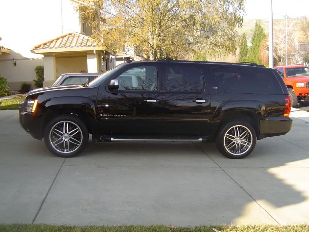

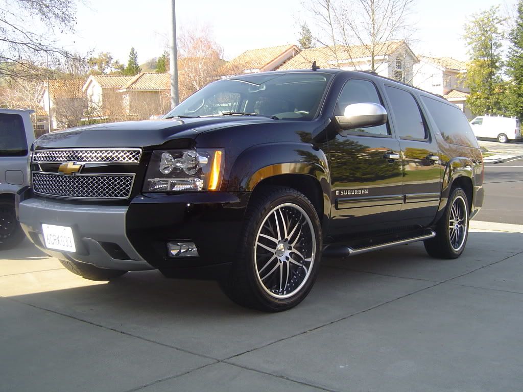

The Drop:
The amount lowered on this installation seems to be about 3 inches. This is a nice sporty looking drop that people definitely notice, yet it still looks classy. This is not the drop for you if want that ultra slammed look. Trust me though; people will still stare in admiration. Wheel gap looks slightly less than a stock GMT800 and a lot less compared to a stock GMT900.
I have 22 inch rims and experienced slight rubbing at full lock before the Pedders install. At present, rubbing is more pronounced, but only at near lock (basically only at parking lot speeds and not at all during normal driving). I have not yet bothered to clearance anything yet because the rubbing is not very severe. I could see why the Pedders would be a great option for those who have 23, 24, or 26 inch rims but still want to lower their rides. Any lower than this drop could present major rubbing issues.
Before:
After:
