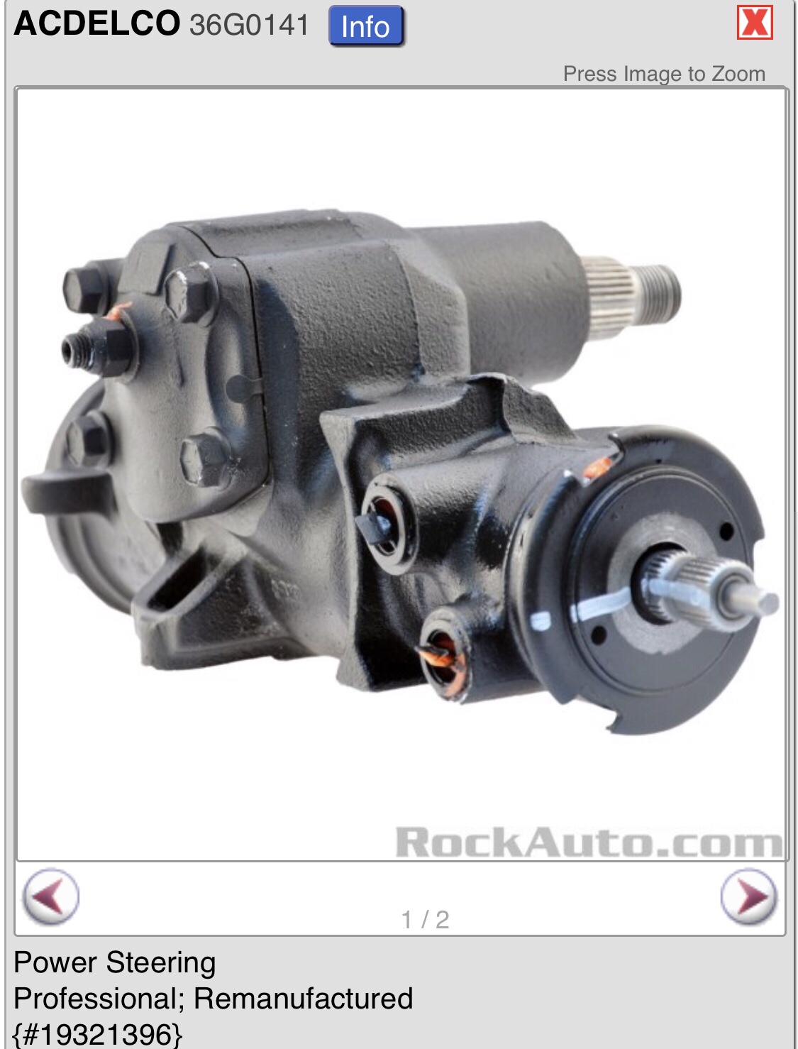

GM changed the steering gearbox for 1997.
I have two 98s, both with functioning EVO. One has a stock steering gear, the other a gearbox from a 96 or under. The 96 and under box is noticeably firmer where the 98 is pretty loose when you first get in it and before you get used to it again.

Has the steering gear on the other (better handling) 99 been replaced? Pull the collar back where the steering shaft connects to compare the connection.
A 96 and under style will have a visible snap-ring...
The 97 and up style will not...
More information on it:
https://www.gmt400.com/threads/steering-box.44132/

I checked on both of my Tahoes and found the one that feels correct has the PS line run a different way that the one that doesn't. It still has the EVO so I will not "fix" it because it isn't broken. The sloppy one that I eliminated the EVO seems to have a little slop and click in the box itself. If I do change out the box and pitman arm it may tighten up. Not sure if the bypassing of the EVO will still make it steer way too easy but I believe that is a pump, orifice issue and maybe I'm just not used to it. Have you ever adjusted the box itself with adjusting the gear with an allen wrench? I figure it is worth a shot before pulling it out.

I have not tried adjusting a box before, I hear that it is a stop gap measure that may make things worse.

I’’ would definitely swap the pitman arm if you’ are doing the gearbox, it’ is being removed anyways. An impact makes quick work of the arm. My 98 has a Bluetooth brand box from the 96-under style. It’ is definitely stiffer than the newer style one on my other 98.

Thanks for that tip. I would rather have stiffness to the steering than not. I can put a 96 box into the 99? I am sure they will line up but is the gearing of the box the same? In other words, the steering wheel will have close to or the same number of turns from full turn left to full turn right.
east302
Jan 1, 2008
92
The ratios are the same unless you order a quick ratio box. Mine bolted right up, no issues.

it ended up being the pitman arm. The box was tight and ok. It was not the original pitman arm and the last guy who installed it did not use a new lock washer so inevitably it loosened up and wore out. Problem solved. thanks for your help
