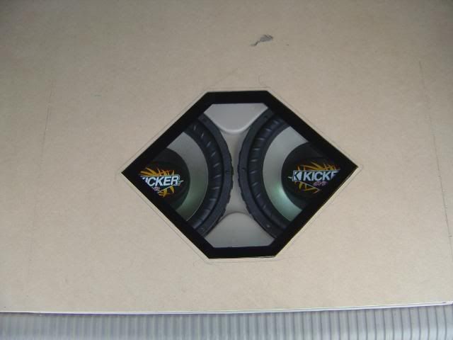

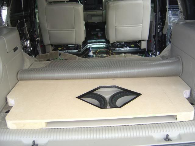

(3) Alpine Type X (sealed) and Chambered for each sub (1.4 cf for each sub) I also wanted to keep my third row. The cut outs on the bottom are for the rear seat levers.

damm thats pretty sick do you have to slam the tail gate to get it to close or does it close without any trouble mine barely fit

Looks sweet! Wish I could keep my 3rd row but I carry too much crap and the animal would get the rear dirty, might try building a ported box for a single 12 that would work with them cuz that 3rd row would be nice at times.
Nope, fits like a glove. I can even slam it with the third row up (clears the excursions)

Go for it!! a single ported 12 would be great, there's more room than I had thought, my box has a total of 4.2cf.
Your 12 would be like 2.0 - 2.5cf ported? maybe do a downfire, so you can put stuff on top of the box.

hey bro, do you get a lot of rattling, or does the fact that the subwoofers are facing the front help?

bro, how is your truck?
It looks like the box is below the trunk?!?!?!?
That looks hella nice, which is why I'm asking....
Does it rattle at all?
Correct the box is below the window, so I can see out when I look through my mirror.
Rattling....i guess there is some, mostly the rear vents above the tail lights but I can't hear them when I'm inside driving :thumbsup:
