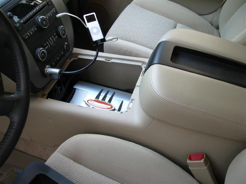

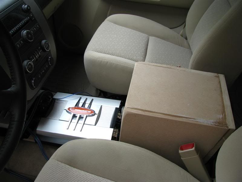

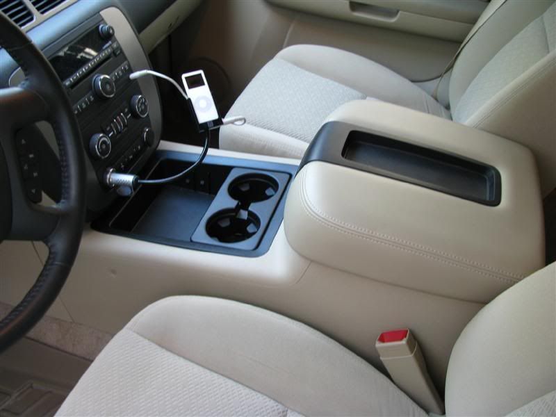

I'm finally posting some pics of my install. I'm still not totally done with the grille for the back of the console. I'll post pics when I get that done.
I did not have Bose in my Tahoe, and the non-Bose speakers suck even worse than the Bose speakers. I wanted to keep a stock look and add new speakers, amps, and a subwoofer. I originally had the front jump seat and that severely limited my options. I decided to buy a center console and fill the innards with the new components.
I ditched the rear speakers as there really is no point for me to have them. It just makes balancing everything more difficult without really adding anything.
Edit: I've gotten a couple questions on how I'm using my factory head unit. I'm using this harness which gives me RCA outs (as seen in the first picture hanging down).
Here are the results:
Cadence Amps (FXA-102 and FXA-3001):
Amps and Sub Box:
Subwoofer (Boston Acoustics G510-44):
New tweeter location (Alpine SPX-17REF):
Enclosure on, cupholder off:
Inside enclosure:
Enclosure reassembled:
Speaker grille:
To-be-completed...

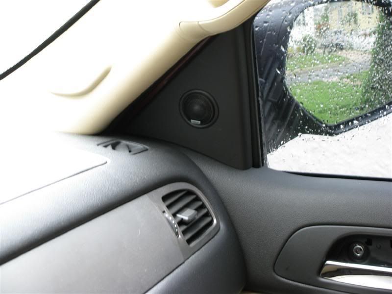

I am interested in your little modifying of the front tweeters....did you just pop off that plastic piece, mount the tweets and your good to go????? Look great.

Pretty much, I drilled a pilot hole in the plastic piece, then used a hole cutter to get close, then used a dremel to get it the rest of the way. The tweeters clamp right to the plastic piece and I just ran the wires inside the door. Pretty simple.

Gambler. Did you consider using the stock tweeter location. Is it feasible? Looks great!

Yes I considered it and after discussing it with some audio guys it was determined that bouncing the sound off of the windshield is generally a bad idea.

Actually using a-pillar mounted tweeters has become more and more popular among car audio competitors..when executed properly they not only lift but widen your soundstage...off course tuning and crossover points are crucial in making them work properly...GM actually did their homework...they are much better up their than where they originally were on the GMT-800's.(in the doors)

I'll agree they are better on an a-pillar than on the doors, but they really aren't aimed well. They appear to be aimed at the windshield to reflect the sound back toward the listener, and that isn't optimal. I played around with where to put them and like them best where they are.
