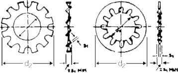

Always best when used with a star washer to cut through the paint and primer to ensure a good ground.
http://www.circlipindia.com/images/star_washer.gif
