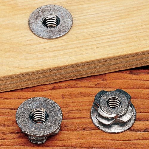

  • When mounting the sub I found it much nicer to use screws or bolts with thread insert/cap things as it gives the sub a much more solid place to mount to. It also aids you if you have to remove the sub more than once. Since I don't know how to describe them here are a couple pictures.
