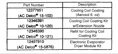

Yea, the blower control makes a big difference. I listed below the part numbers for the related procedure for you and anyone else who might need it.

Thanks!
Now I'm looking them up on the internet trying to find them. Wow, one place has some of those cans of spray for $139 each!
