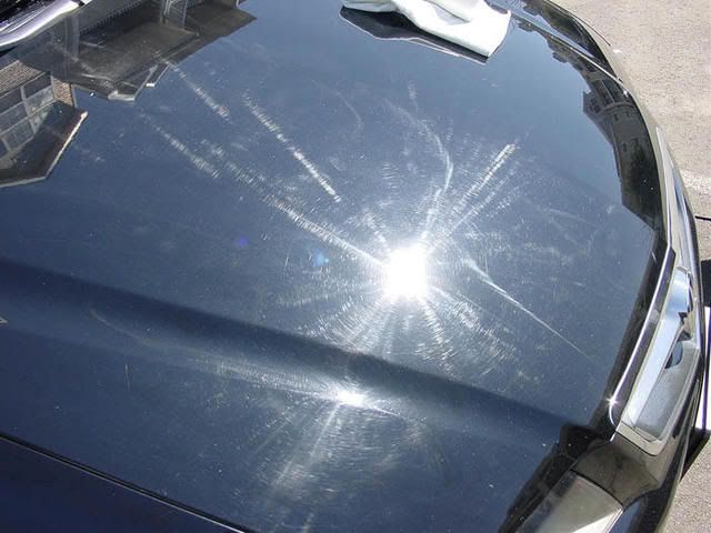

I'm guessing that you car looks simular to this
These are your average swirl marks...these can be caused by simply not washing your car the correct way...the people you took it to obviously didnt know what they were doing haha...first mistake is that these "professional" detailers could probably care less about your car just want the money...I have never taken my tahoe to one...not to be rude or anything but in most cases like this, if you want something done right your probably gunna have to it yourself...easyiest way is to do the steps...and you may want to "polish" it twice not wax...wax will just cover them up polish should take them out...use a buffer when polishing and just work it into the paint and you should be good to go, and you will have to the clay bar...b/c you want your paint to wax free when you polish it...I've seen way to many people just start polishing they're car after it has a coat of wax on it...and it takes about a day to get all that polish off haha...bc wax protects and it won't let anything through it...so def need to clay it first then polish...then wax
