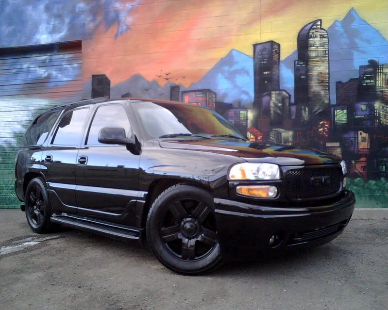

Me and a buddy have over 3" of drop from stock 3/4 ton chevy keys with no issues with alignment. My truck drives just like it did stock but handles way better. I honestly don't know how much drop mine got up front but comparing fender heights with another stock denali I was 4" lower all around. Spindles or some djm lowers
are a much better choice but I'm somehow an exception to the rule. Buy some shorter shocks, stock purple keys, and some 3" coils out back
stock:
dropped:
Or go with a 3/5 or 4/5 drop like JK and it will look dope as fu*k :thumbsup:
stock:
dropped:
Damn your Denali looks sick. I'm normally into lifting trucks, but your Denali really makes me want to lower my Hoe.
Me and a buddy have over 3" of drop from stock 3/4 ton chevy keys with no issues with alignment...
That's cool. I wonder if there are different stock camber plates available for different models:confused2: . I know I dropped a little less than 3" the first time and I had no room left to add a few needed degrees of camber adjustment.
Yeah all these chevys are different, my brother's dmax rode like a dream with a leveling kit and 33s but some trucks ride like bricks. Mine being an 02 I'm guessing the springs are soft and the 6.0 puts more weight on the front end, or I'm just talking out my ass and I lucked out on my truck. You can buy adjustable eccentrics for these trucks tho.
