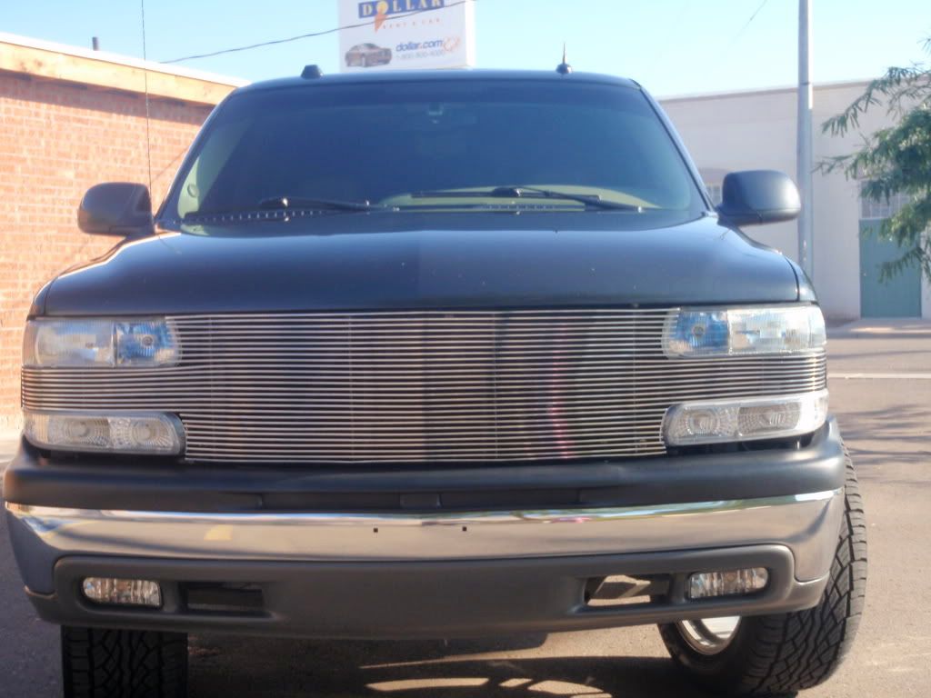

Here is the grill:

love those wheels. nice Hoe, cant wait to get my 3/5 drop.
Truck looks real good man. Less wheel well gap definitely looks better imo when running bigger wheels.
