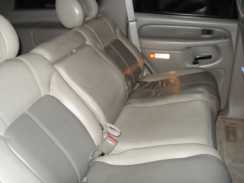

I have a 2002 GMC denali and want to know what needs to be done to replace my 2nd row captain seats with a 60/40 bench seat. We now need seating for 8. Can it be done? Does it use same mounting brackets? Let me know.

Uses the same brackets and is a drop in replacement.

As said in the prev. post, you should be able to direct swap them. We have a 60/40 bench in our Yukon I'd part with for a set of captains chairs.....

They are a direct bolt in. Just get all the plastic pieces, like the pivot cover on the bottom rear of the seat. I just changed mine from a Bench to the captains.
Just make sure you get the seats out of the same body style. Tahoe seat will not fit into a Suburban and vice versa

Thanks. I found out that we would need to have the 60/40 seat come out of an XL or Suburban in order to fit properly.
