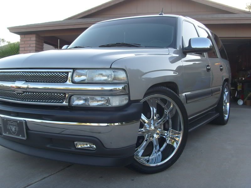

If your concern is fitment or rubbing with the drop, the 22s with 305/40 should be ok with the proper offset wheel. I'm running 305/35 on 24s with the same drop and have very little rubbing. For looks, I think either would look good with that drop.

If your concern is fitment or rubbing with the drop, the 22s with 305/40 should be ok with the proper offset wheel. I'm running 304/35 on 24s with the same drop and have very little rubbing. For looks, I think either would look good with that drop.
I'm similar to JK's setup with minimal rubbing at hard turns and/or bumps/dips. You get used to approaching those tho'..
