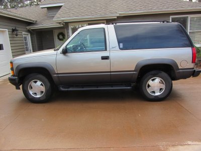

I am the original owner of a 1999 Tahoe Sport 4 wheel drive with the Z-71 package. It has been an excellent vehicle.
