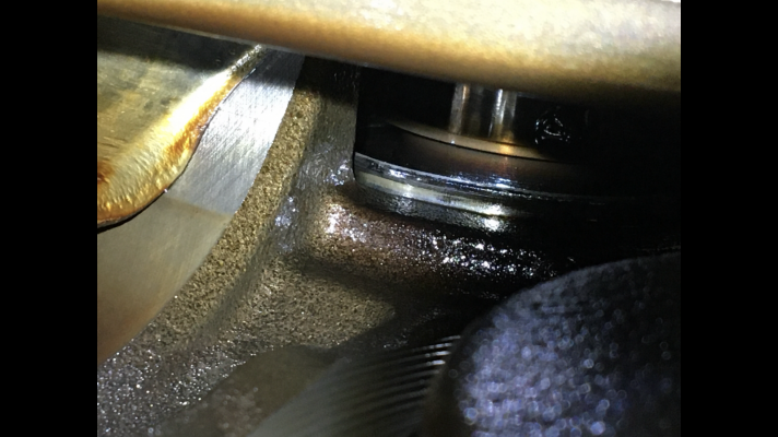

Hi Keygun, i see this is now more than a year ago posted, but just curious as i have the same problem right now.
We dropped the oil pan and checked the seal on the oil pickup pipe. That was was o.k. the oil pump is also ok but was not ok is the camshaft alignment. we could see this was was 3mm coming out of its place,
The engine is now being taken out of the truck to fix this.
Am curious what was your issue in the end?
I am guessing not the oilpump...
