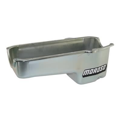

I have a 1998 Chevy Tahoe.. When I purchased the truck the guy before me stripped the drain plug.. So im unable to change the oil now since I bought the truck..
I have a two options:
re-thread the plug and put a larger plug in..
or
replace the oil pan?
Any other options?
I found this guy selling Moroso Oil Pans for a good price.. I believe that this is the one for my specific vehicle?
http://www.lightningmotorsports.com/moroso_/moroso_oil_pan/20186/i-296957.aspx
Part # 20186
Is anyone else running an aftermarket oil pan like this? This is an OEM replacement..

First off, Rockauto.com has one for $50.
Second, the price on the shiny one is $100 too much.
Third, the second pix looks to be a racing type pan, with pickup and drain plugs for the turbo lines, and probably has a splash type setup in the bottom to keep oil in the sump when cornering hard, IDK what that is called anymore, but you probably dont need to spend all that $ on either shiny pan.
If it were mine, I would look into an oversized plug or something......

WoW thank you so much for finding giving me that link.. That is A LOT cheaper then anywhere else locally I have contacted..
Do you happen to know the differences between each of the pans you linked me to:
All of the pans below are 4 Quart besides the last one in the list is a 5 Quart
$48.79 SPECTRA PREMIUM Part # GMP02A
$50.79 DORMAN Part # 264100
$58.99 ATP Part # 103033
$77.79 DORMAN Part # 264132
I already purchased the larger drain plug but then I was thinking that it would probably be better in the long run "reliability" etc that I look into replacing the actual pan?
What are other peoples thoughts on this? If I just put the larger plug in that would rethread the hole and then I would have no problems changing the oil etc in the future?

What would this forum recommend that I go with? The cheapest one because they are all pretty much the same? The person response regarding the one larger one that there site has listed for my vehicle is really vague..
So im thinking to go with the cheapest priced pan go with this magnetic drain plug for $3.07

What does everyone think? I know that the pan comes with an OEM replacement plug but I figured for the small price of the upgrade that I would upgrade to the nicer magnetic plug..
I think I will order this package tomorrow morning?
Thanks lesterl for the information.. :happy160:

Sounds good, the oil pan will have to be replaced with the engine pulled or at least lifted up out of the vehicle a ways.... ///FYI
Good Luck anyway.
