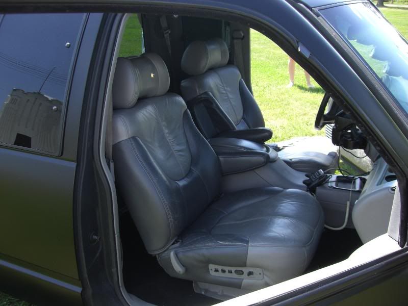

for the console you will have to flip the bracket around so the console slides in from the back instead of the front..other then that it bolts right up..i did this swap in my 95 silverado..best mod i ever did..also yes block off your lower heat vent..anything in the console gets super hot
In this picture, you can see the bracket between the seatbelts..this is the way it has to face

damn guy that looks sweet.. thanks for the info.. did u use the 6 disc changer with your radio?? thanks
Nickleahy23
Sep 23, 2008
100
Portage, WI/ Menomonie, WI
Thanks man..the denali seats/console is definatly my favorite mod to the truck..
nope i didnt use any of it..there is a BCM (body control module) on the denali/escalade that is required to use the bose sub/amp and cd changer..its all tied together, along with the controls for the rear..i ripped out the sub/amp..you wont believe how light the thing is without those in there..also a ton of wiring..
to tell you the truth, i never looked into the cd changer..i guess if you could adapt the harness to fit one that plugs into your deck it could work..but im not sure..its still just in the console.

I don't mean to go off topic, but your truck looks great! How hard was it to mod the denali front seats so they worked the same way as your old seats? I'd love a pair, but am curious to know how to get them to slide back and forth like my current seats do in my 2 door Tahoe.
Nickleahy23
Sep 23, 2008
100
the seats were a breeze to install..the drivers side bolted right up. the pass. side i had to drill 2 holes for the rear, but the front 2 bolted right in..
As far as making them slide, theres jsut a positive and negative you have to hook up to give power to the seats.
