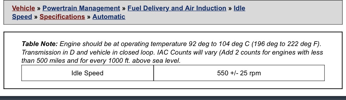

d) I also get your point about the RPM at idle, you are checking to see if I am starving the engine correct? I checked a few other posts..seems idle should be a bit higher...and thus the comment about the IAC above?? Do you know best target idle rpm?? and is my logic/interpretation correct here?
thanks

Here is the spec on the idle, GM gives the value with the transmission in drive.

From the previous work and data I collected using the ELM, the warmed engine was holding steady at 194 F, not sure which PID this was offhand, would have to rerun to confirm. (While the radiator was just flushed, we didnt take tremendous care on the mix ratio, we just approximated since we thought there was probably leftover water in the system from the final flush rinse.) Seems this is thermostat controlled anyway.
I will check the in-gear idle RPMs tomorrow..but it sounds like Im not far off, if at all, from where it should be.

c) For the RPMs, I used PID 221191 (TCC Slip Speed), 221192 (Desired Idle) and 0c (RPM). They were consistent and with warm engine and parked , as indicated previously, it was 625 +/- for all and in Drive (Brake on obviously) it dropped t0 550-560 rpm for all. Quiver present under all conditions tested.
