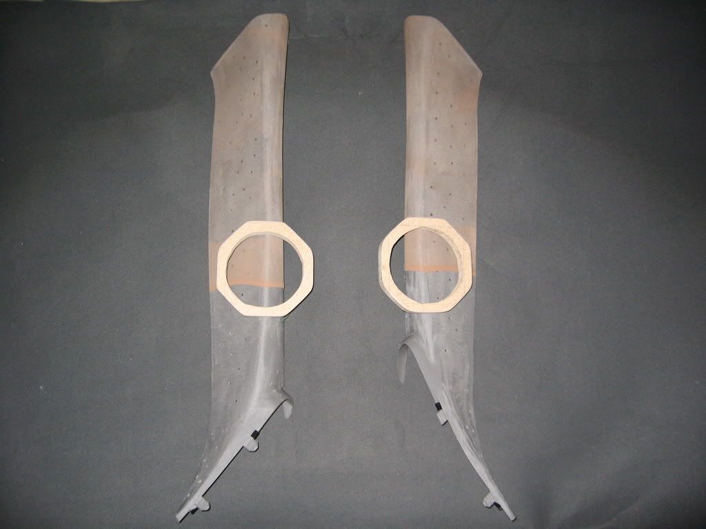

Im doin some audio to the Tahoe and startin with the A-Pillars. I figured I'd share cuz its a Tahoe!
These are just sanded with a disc just to rough it up. Drilled holes so resin will bond a little bit. The pantyhose won't fill the panel too much so it will go in after I'm done.
I'm making baffles today and have to test the drivers before I wrap but you will get to see everything! Later Guys!
