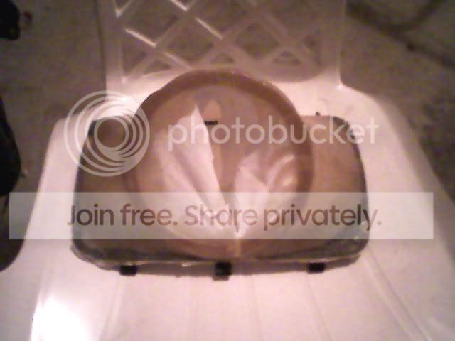

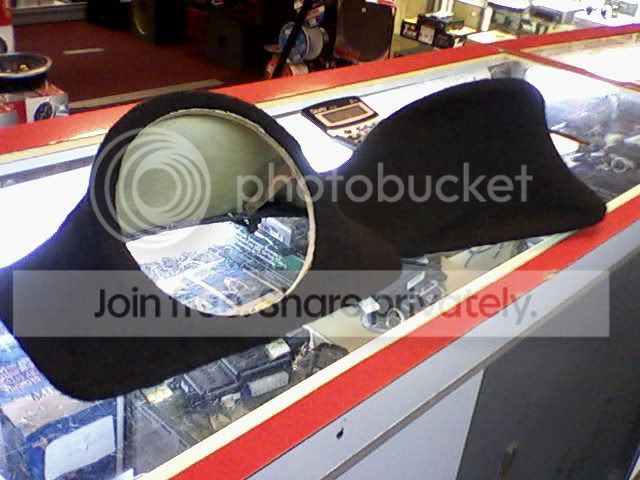

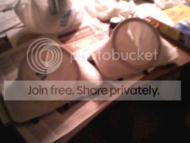

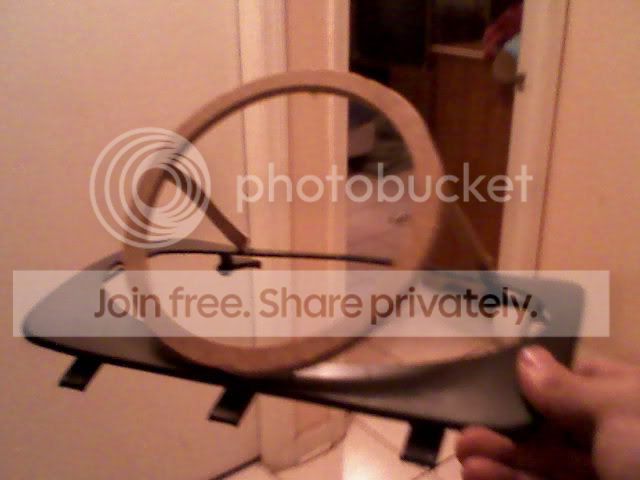

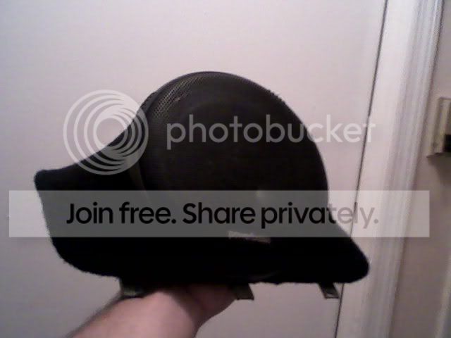

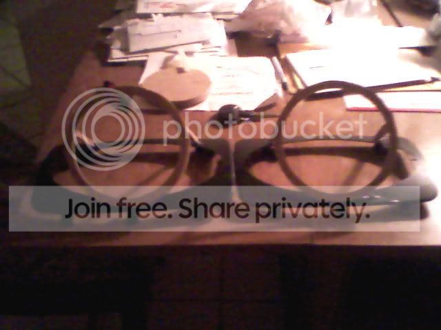

    i made these for TahoeGoBoom. it replaces the factory 4x10 grill with my pod.

    what do you guys think?
    do you think if i made more of these people would want to buy them?
    they should get installed sat or sunday so i hope i will get pics of them to post

    they use all the factory brackets that hold the old cover up. that cover is a bitch to take off so i figured it would work fine to hold the new pods. i build my pods off the old 4x10 grill. as you can see in the first pic you would have to put you hand through the speaker then twist the rear lock into place.

    you realized that the covers do not flex anymore after they are glassed and all. so what is holding them up would be the 3tabs in the front and the 2 tabs in the back.

    it took about 3hrs from start to finish including drying time.

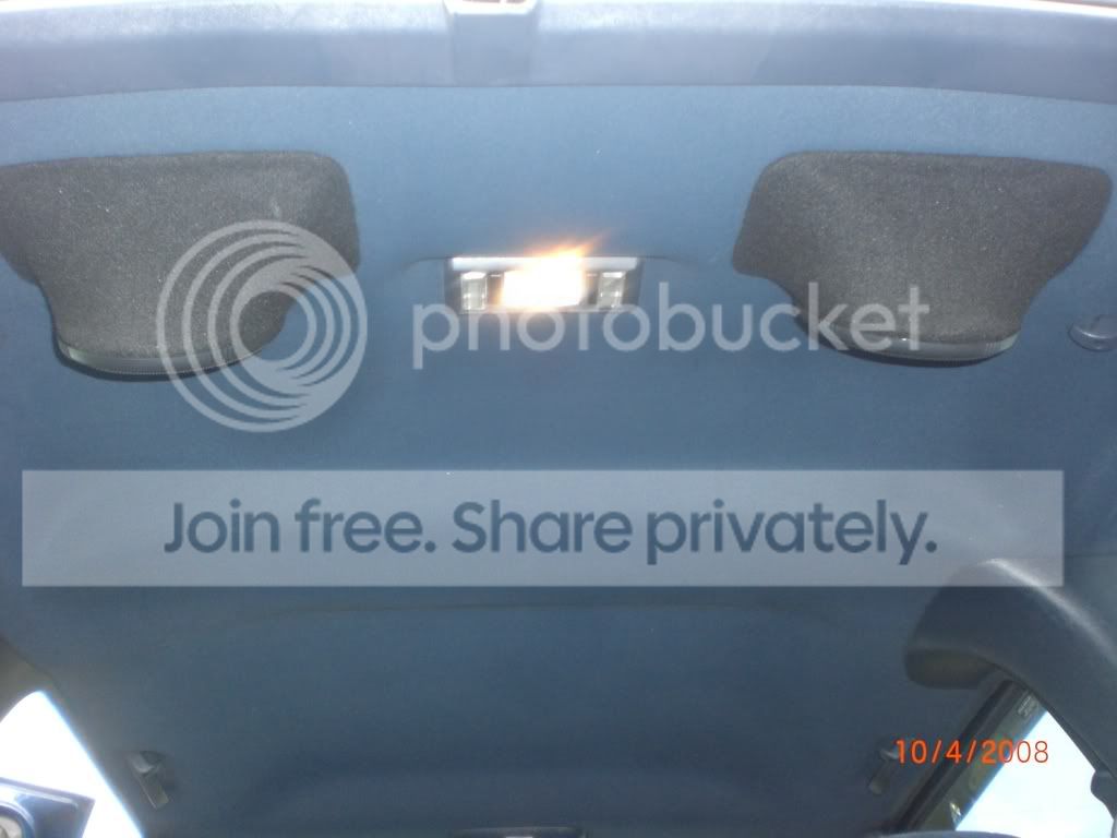

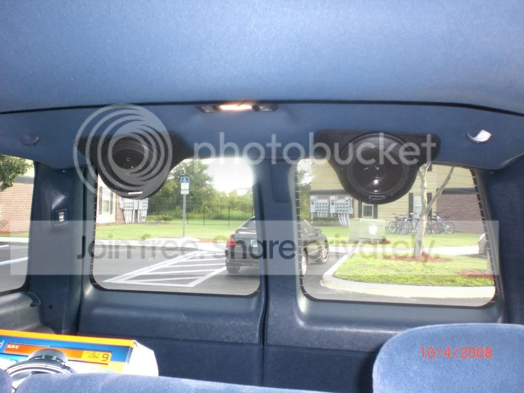

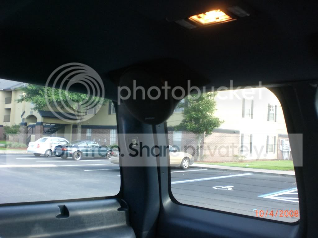

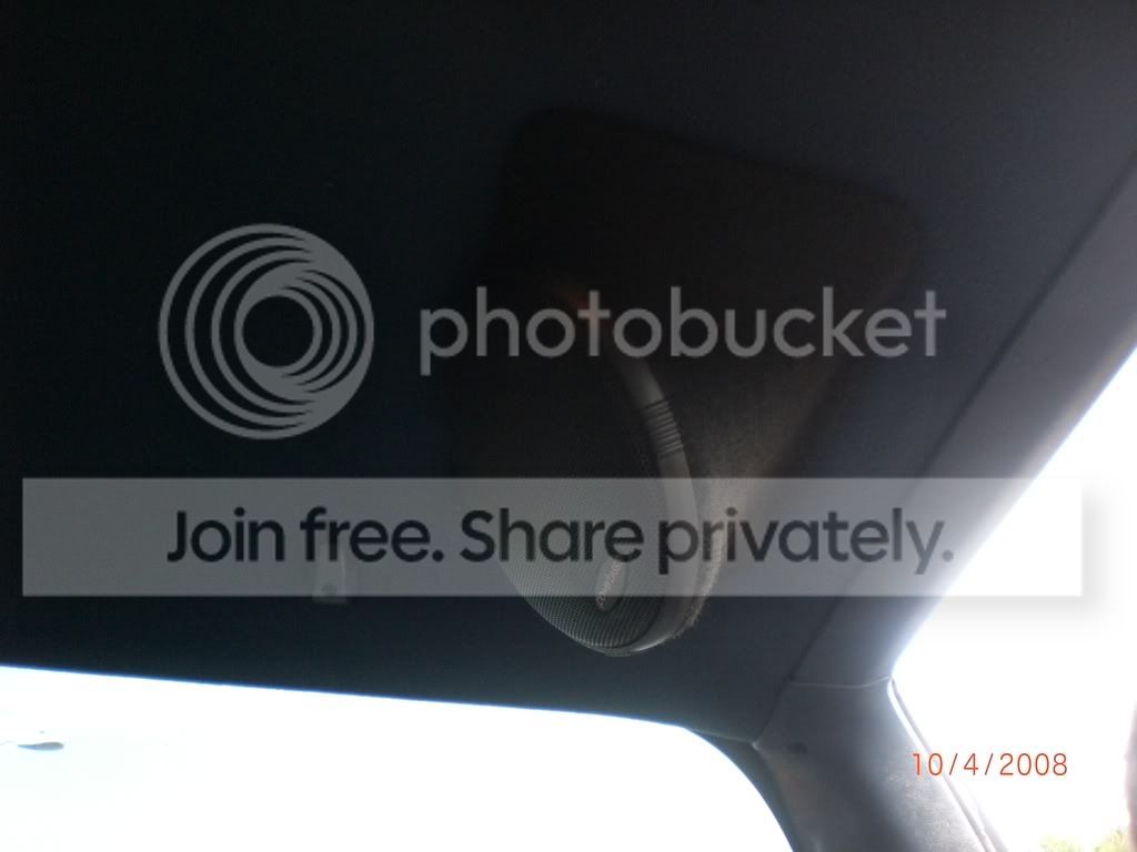

    Heres the pics of em finally in. they sound amazing.

    this is the first time i have seen them in the truck i am real happy with the way they look.

    they turned out really good. how solid is the fit?

    They fit in real good. and they sure as hell arent comin off. they only thing I will say is dont buy cheap speakers with these things, cuz beware, YOU WILL HEAR THEM. dont say, "oh, there in the back", and buy somethin cheap. cuz they make for a perfect split between front and rear.
